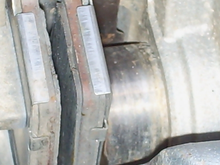

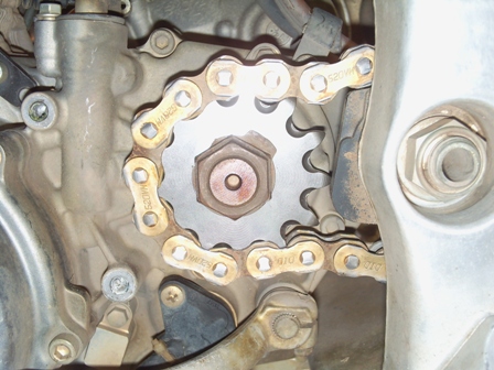

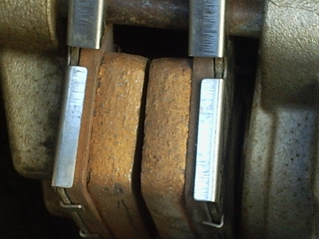

Pulled the bike down after the weekends HCR ride having noticed a drive chain noise and not much rear brake.
Turned out the rear brake pads are shot and the front sprocket nut was loosed held only by the folded over washer.
The front sprocket is also on the way out.
Rear brakes 1mm to spare
Front sprocket on the way out

Got the stealth on here are the combined shots looks allot better.
Old rear pads
New rear pads
Old front sprocket
New front sprocket
And I thought I did enough maintenance, not true on this occasion. Hope this helps to remind folks to be prepared for High Country styled riding.

Old front sprocket
[img]http://www.vinamtra.com.au/forum/gallery
That's a pretty bad looking sprocket Dr Brad, i hope you don't ever come on my rides with a Counter shaft sprocket looking like that!!!

Yep pretty bad its amazing how quick it wears when on the way out. Still had all 13 teeth, the brakes were just as bad will bring the remains around next meeting as a show of what NOT to let it get to.
