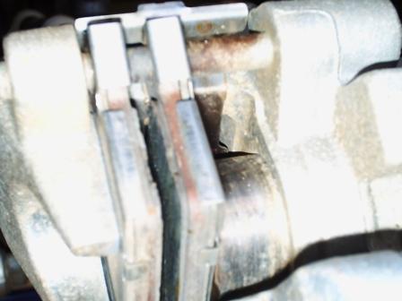

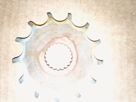

Pulled the bike down after the weekends HCR ride having noticed a drive chain noise and not much rear brake.
Turned out the rear brake pads are shot and the front sprocket nut was loosed held only by the folded over washer.
The front sprocket is also on the way out.
Rear brakes 1mm to spare
Front sprocket on the way out

Gee Brad - that looks like close to "great exercise" or was it a case of "value for money"? Always potential for getting trapped with the sprocket lock tabs, need to un-lock them to check the nut tension, but the tab did it's job for you. I would say you made "value for money" with the sprocket and pads, as long as you were carrying spares of course?

Old rear pads
New rear pads
Old front sprocket
New front sprocket

Old front sprocket
[img]http://www.vinamtra.com.au/forum/gallery
That's a pretty bad looking sprocket Dr Brad, i hope you don't ever come on my rides with a Counter shaft sprocket looking like that!!!
« Reply #5 on: January 21, 2011, 04,58:32 PM »
Yep pretty bad its amazing how quick it wears when on the way out. Still had all 13 teeth, the brakes were just as bad will bring the remains around next meeting as a show of what NOT to let it get to.
